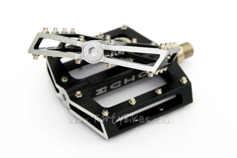

Lightbulb Echo 2010 components.. save weight, and make your uni stand out
For those that need it or care, save weight.
ECHO SL platform pedal
Super light, 282g per pair.
super slim, 22mm thickness..
Titanium axle and pins.
one piece 6061 body, CNC milling.
sealed ball bearing + DU bearing.
In black color only.
ECHO seat clamps.
AL 7075 T6 aluminum body with titanium bolt.
For 27.2mm seat post use.
13.5g
in 10 different anodized color.
FULL INFO: http://tartybikes.co.uk/product.php?...category_id=72
FULL INFO: http://tartybikes.co.uk/product.php?...category_id=23

Very cool, nothing worth fainting over though. Those pedals look pretty similar to the wellgo mg-1s with ti axles that currently exist.
I'd be interested in hearing reviews on those brakes though, I wonder if they will provide smoother braking than the HS-33s.

These new Echo SL Ti pedals look and feel absolutely nothing like Wellgo MG-Tis. Totally different shape, and a bit lighter and meaner looking.
Worth a shot, the platform seems a bit wider. I held both in my hands and compared.
