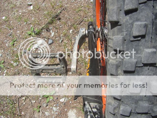

    UPD'd then uni went bouncing 300-400m down steep rocky slope. Frame no longer aligned with bearings (a few cms off, but can be forced into place).
    The internet seems to tell me that once you bend an aluminum frame, it's game over as aluminum is weakened by this, and would be weakened still further by trying to bend it back. For muni riding it seems I need to get a new frame.... ?

    Aluminum tubing can be straightened after being deformed without weakening significantly if it hasn't been stretched. My concern would be getting it back to the original shape. If it's not restored to original shape you'll stress the bearings, and possibly end up with handling issues. Even if you have access to the tooling to straighten the frame, I think you would spend more time, energy, and money with less than perfect results. If it were me, I'd buy a new frame and use the old frame for a project, or sell it to someone for a project.

      Aluminium quickly becomes stiffer with work so it would not necessarily be weaker if the deformation is not excessive which it does not appear to be.
      However any dent is always going to be a weak point where a collapse could start again. Unless you can fully return it to the entirely convex original shape it won't be as strong. Without access to the inside of the tube I doubt this is possible.
      BTW Aluminium can be dramatically reshaped without fatigue when heated to the temperature that makes oil smoke. However such heating would anneal the work hardening that came from the tube manufacturing process so it wouldn't be a good solution for this problem.

                IMO for bouncing that far it's impressive that it survived as well as it did. You could heat it up and straighten it and see what happens. It will obviously never be as strong again but there's a good chance that you could get quite a bit more use out of it before having to purchase another frame.
